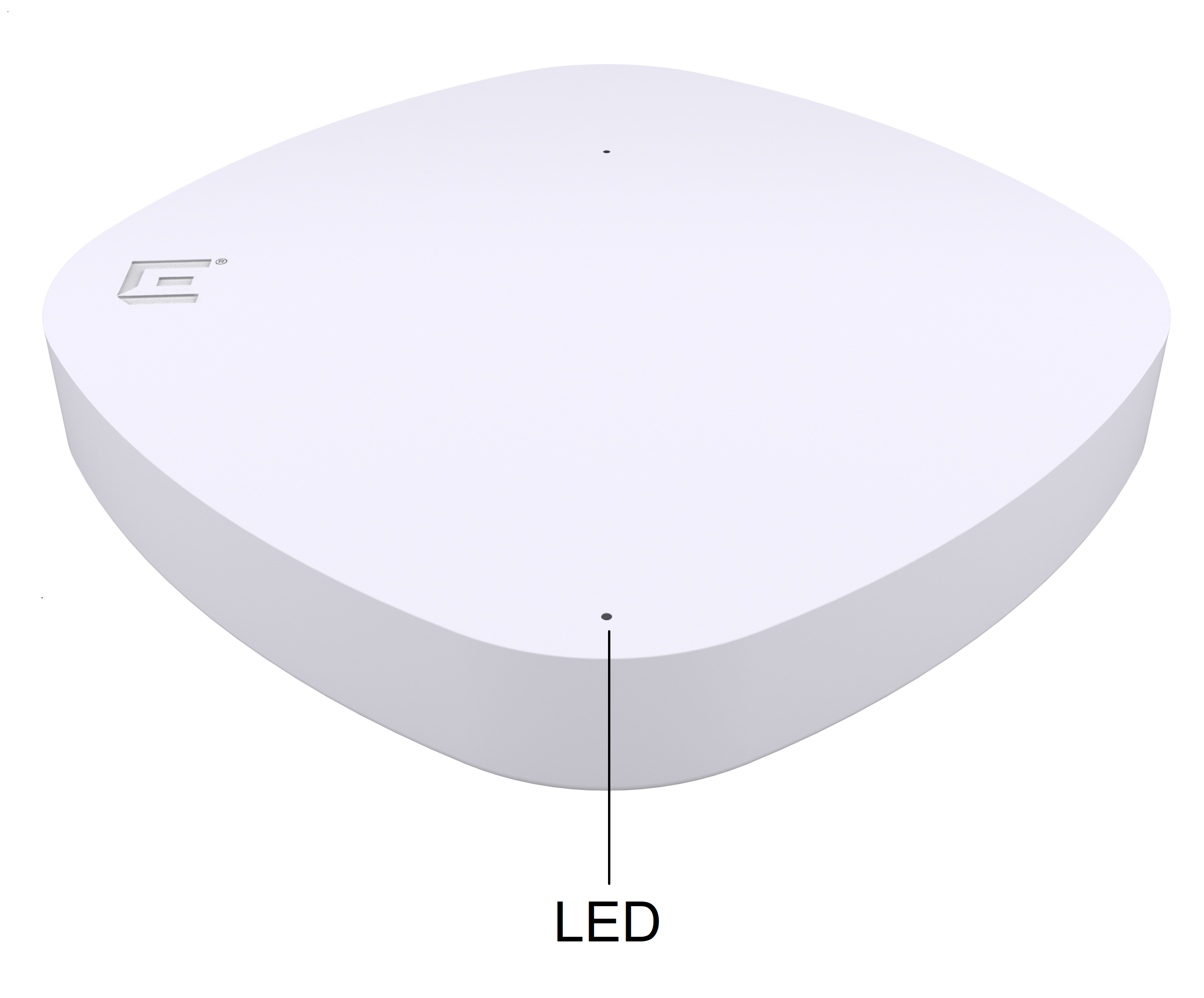

Your Extreme wireless AP has an LED status light that shows the AP's operating status. A solid white means that the AP is working normally. A solid or blinking amber indicates an issue.
Status | Activity |
Dark | Power is Off. |
Solid white | The device power is on and the AP is ready to use. The device has successfully established a Control And Provisioning of Wireless Access Points (CAPWAP) connection to ExtremeCloud IQ and is operating normally. |
Slow-blinking white | The device has a CAPWAP connection to ExtremeCloud IQ, but is operating on 802.3at power instead of 802.3bt power. |
Solid amber | The power is on and the AP is in boot up mode, or is running without a CAPWAP connection. |
Slow-blinking amber | The device has no CAPWAP connection to ExtremeCloud IQ. It is operating on 802.3at power instead of 802.3bt power. |
Fast-blinking amber | The IQ Engine firmware is updating. |
Status | Activity |
Dark | Power is off or the AP is taken over by the controller. Configuration pushes down to AP from controller to turn off the LED. |
Solid white | The AP is starting up or is already taken over by the controller. |
Slow-blinking white | The AP is being taken over by the controller or has failed to be taken over by the controller. |
Flashing fading white | Configuration pushes down to AP from controller helping the user locate the AP by sight. |
Solid amber | A firmware upgrade is occurring. |
Fast-blinking amber | The AP is acquiring the DHCP IP. |
